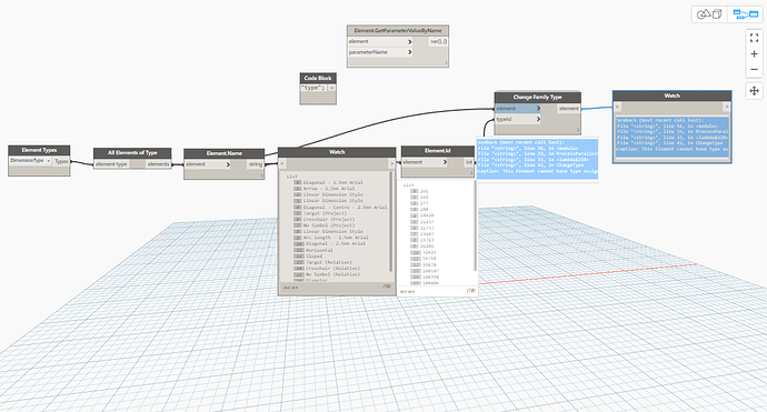

My end goal is to select all the dimension types and force them to one type. (Which you can do with all kinds of other objects, are dimension the exception?)
Thank you!
Thank you!
You need to use feed just one family type id
Currently your feeding list. Use Element.Id from clockwork package.
