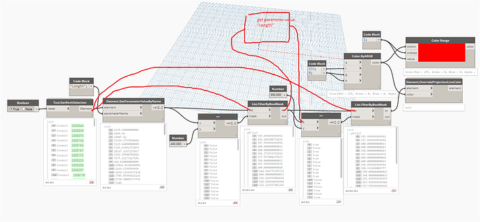

Firstly, I am new in dynamo. I create some script for electrical conduit. Its filtering conduit length between “300 to 400”. For example i find 15 conduit in this filter. I want to change selected element color in active view. I try to use
Element.OverrideProjectionLineColor
But ,I still can not reach the success. Maybe somebody can help me ?
your input to the override Node is wrong, the Element need conduit not numbers values
so you have to get first the element from first filter by bool mask, then get Length again, and get filter by bool mask from the element again, see image below :
