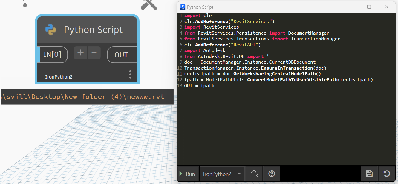

Yeah not sure ootb is in2020 cant remember :wink: but then genius loci should work i guess…or you can try this one here should work in 2020
path Home.dyn (3.5 KB)

I’m getting this in R’22
The Project is Worksharing enabled. I’m working in a local file, able to sync with central.
Are you on the latest build of Revit 2022? Any add-ins in conflict?
22.1.70.9
20240704_1515(x64)
2022.1.7
Sorry! I was looking at the wrong Revit version. It was not Workshared yet!
Good to know! I was having a bit of a head scratcher for a minute there. :laughing:
I’ve got it working. Thanks!
