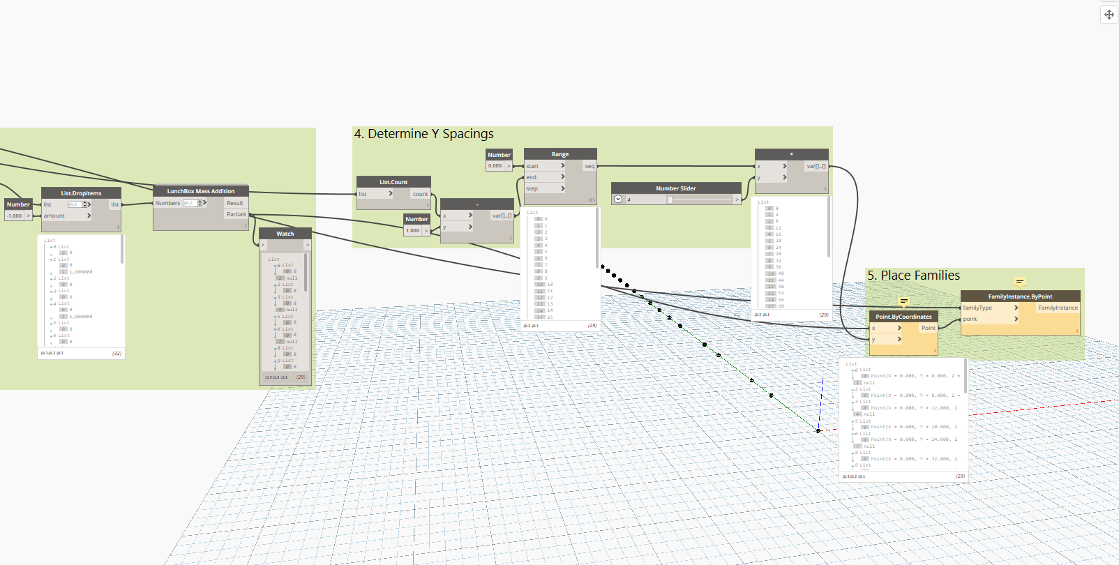

Still struggling with this definition…
It seems that every furniture with more than one type is skipped in the final “place family”.
I know I’ve got “null” values that makes the process incomplete but I can’t figure out why.
