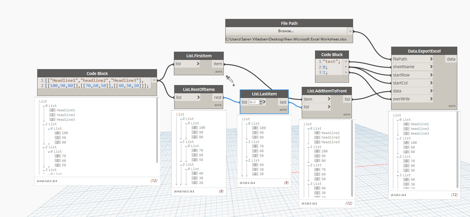

I write this dynamo pattern and run the data to show it on excel, but the first list didn’t show up. How can I fix it?

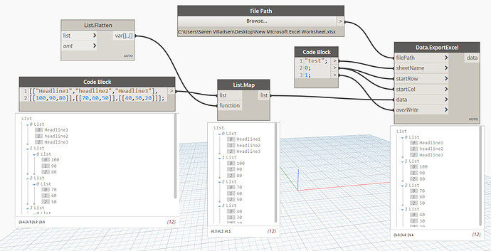

You need to flatten the lists or add the first row of data at the same level.
See how the first group just says “0 List” but the next has “1 List” then “0 List” grouped right under it. Your list structure isn’t consistent.
