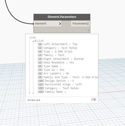

Can we get the type parameters of the Text Note element and mainly its color?
I tried to get all parameters of an element or even get parameter by name and both didn’t work.
Any suggestions?

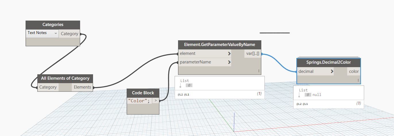

Yes that is the problem I cant get the color !
the main question here why? and what is the difference between the color parameter and other paramerters

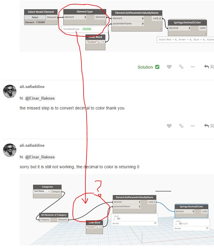

Update: you can get the value with Rhythm node GetParameterValueByName(TypeOrInstance)
the missed step is to convert decimal to color thank you
I think Color is a type parameter for text notes, it could be the reason why…
@Yna_Db but in the above reply it is working with @Einar_Raknes !!
Yes but he’s extracting a parameter from the type also…
