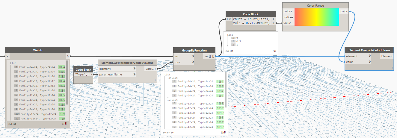

Colors and structural beams + PAREMETER TYPE"TEXT"
I TRY SOMETHING LIKE THIS
BUT WHIT THE PARAMETER “TYPE” OF THE STRUCTURAL FRAMING OR COLUMN.
@isauro_vb What is the error you are getting on the Color Range node?
@awilliams
Just realized I didn’t really need to see the error – you’re inputting a string into the “value” input, which needs to be given a double. Read here on how that node works:
http://dictionary.dynamobim.com/#/Core/Color/Create/

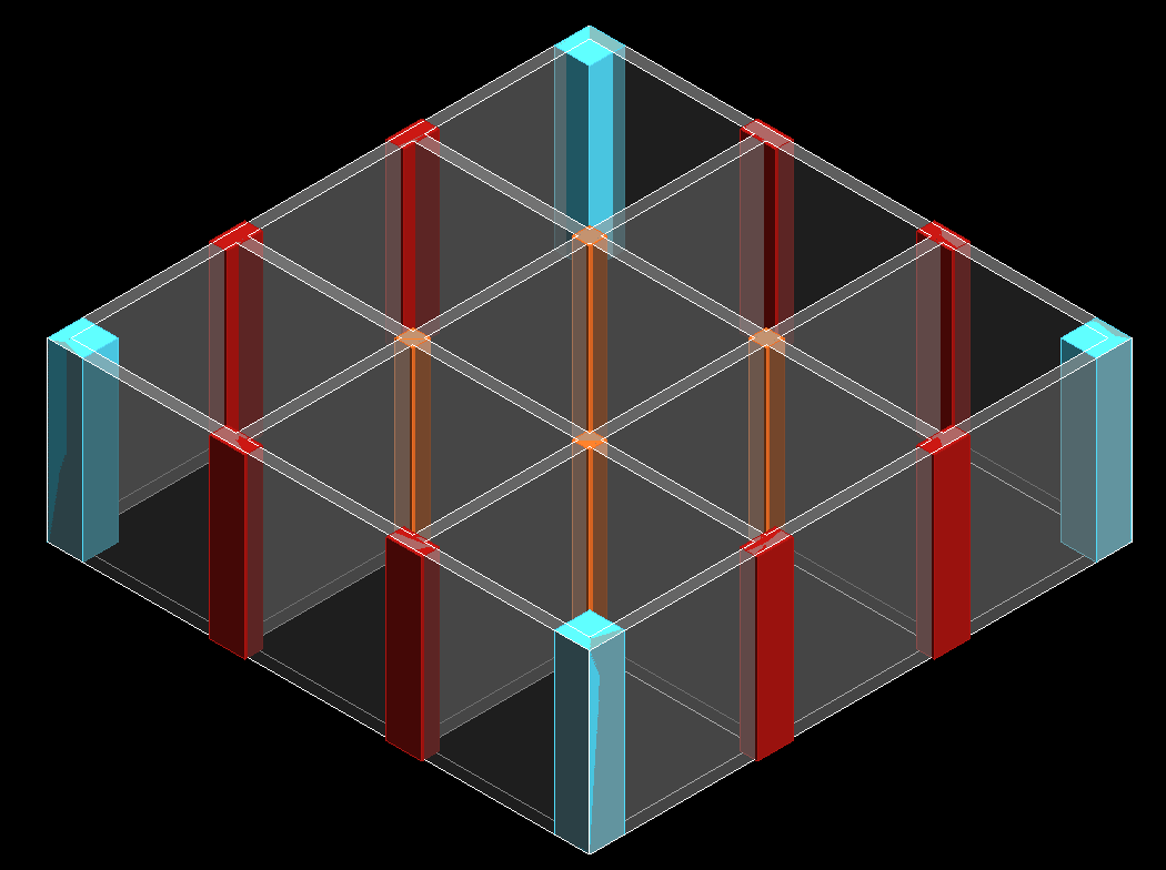

NO COLORED
I’ve seen the POST, but it’s not coloring the elements.
Any recommendation.

this is my .dyn
CM_COLUMNAS&VIGAS_R00.dyn (81.3 KB)
You can use color range but it would probably be easier to use Random Color (from BattleBIM).
You should have no problem with 3D views, but remember that OverrideColorInView only overrides the projection properties. Floor plans won’t show any override if the column is being cut.
EDIT: Here’s how you could do it with a color range.
Looks like you are using “OverrideCutColorinView” What if you change to “OverrideProjectionColorinView”
ops…
@Timon thank you very much, I did not observe this detail.
