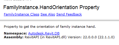

Maybe you can find your answer here:
Get HandOrientation of element I can control direction section.
