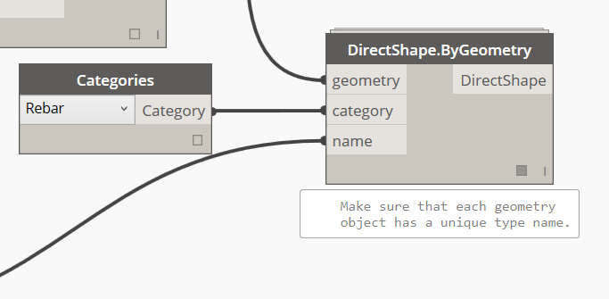

I suggest you to create Rebar Container Family. Use “DirectShape.ByGeometry” from spring nodes package to put your geometry in Revit family. Then add parameters in family and then load the family in you Revit project file. Good Luck!
hi!Kulkul thank u for your help
i tried the command “DirectShape.ByGeometry”,and one more question
if i wanna make "rebar container family "as u suggested ,which category should i choose to create the family?
because i have a problem with using categories,i have chosen rebar,rebar sketches cotegories and so on
but the command showed me this alert…
thank u for your help!

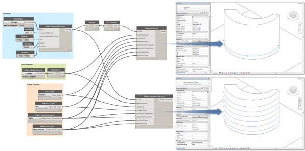

Did you try with Dynamo for Rebar package. It has got 'RebarContainer.Bycurve" node.
