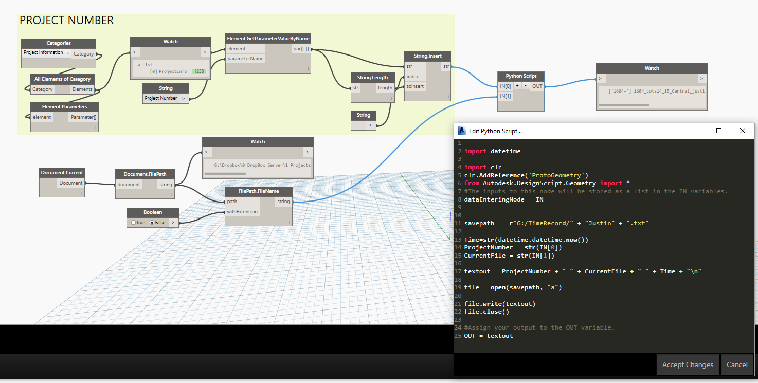

I made a graph that writes to a txt file data from a project. When dynamo is open this record each change to the file. It stops when dynamo is closed. Is there a way to make this run continuously in the back ground when dynamo is not open?
Did you try using windows task scheduler.
If think you should a look at the Revit Api and “Dynamic Model Update”. Boostyourbim.wordpress.com is a great place to start.
