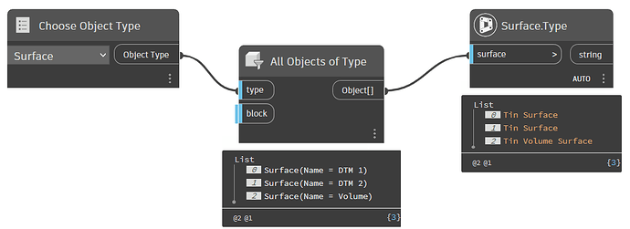

You can use the core node All Object of Type where you don’t select a TIN Surface but the more generic Surface.
The Surface.Type node can be found in The Civil Nodes, and with that you can probably create a Filter By Bool Mask to extract the Volume Surfaces (as Surface).
