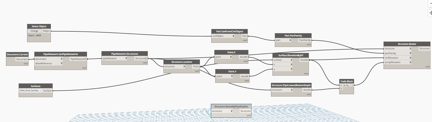

I just want to let you know that with the Camber package I was able to solve one issue I had several times and I could not solve with Civil3DToolkit as I think the nodes do not work properly. Now, with your Camber package, I am able to set RimElevation and SumpElevation with Dynamo. I post a screenshot with the script I created.
I just need to check the node that I have below with no inputs and outputs but with this first approach it works perfectly.
Many thanks and congratulations,

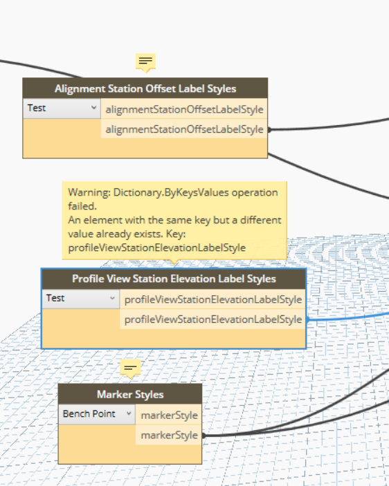

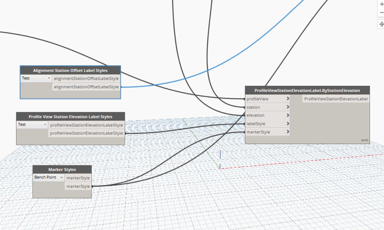

Hi @zachri.jensen,
Come across this when creating labels for alignment and profile. The nodes work perfectly fine for the first time but if script closed and reopened, gets bellow error and script wont run.
The error says :
I am using Civil 3D 2020.4, and Dynamo version 2.4.1.6394 (Dynamo for C3D 2.4.1.2161)
Thanks @shahid.shaikh_C3D. It’s a known issue with older versions that I’m trying to figure out.
In the meantime, if you’re able to update to 2022 then it should go away.
