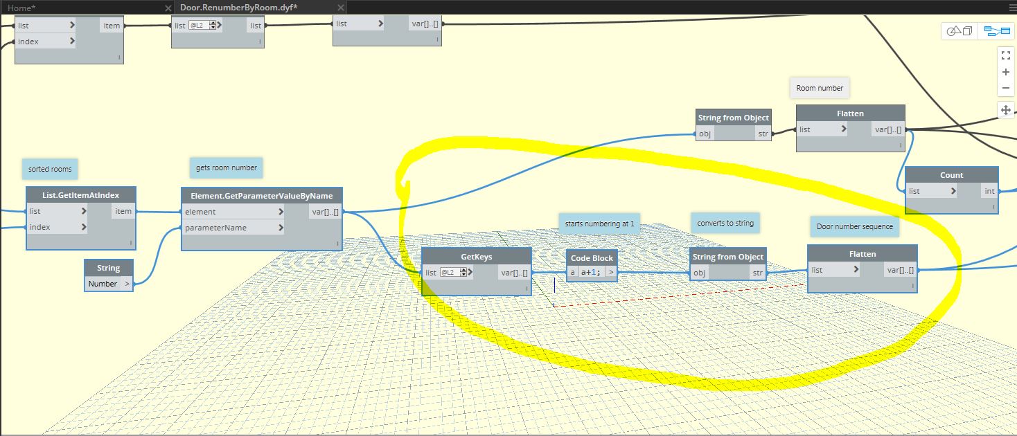

I am trying to do the same as the link but instead of replacing the numbers with the letters, I want to use the Mark Value of the Door.
Example :
Room : 1001
Door Mark : 01
Output : 1001-01

Why not sending a screenshot of your graph? It would make it easier since this topic has been addressed in many different forms already.
I’d like to remove the encircled portion and use Door Mark instead.

Did you try to get the Mark parameter instead of the Number?
hi Yna, my aim is to have the Room Number as the Door number + the Door Mark. So if the room number is 101, and the door mark Is 01, Door number will be 101-01

I guess you could first set the room number to a door parameter, get these parameter values along with the marks and use a String.Join node:
http://dictionary.dynamobim.com/#/Core/String/Action/Join
