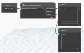

This Node from Clockwork gives me null
Edit
Resolved the null
issue after installing the DynamoIronPython Package.
Canβt find something which looks like a Cut Profile or FaceSpliiter BuiltIn Category though.
