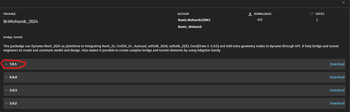

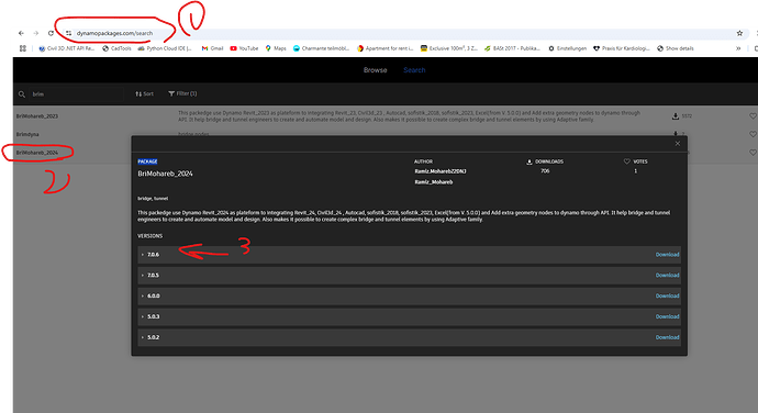

Hi
I’m unable to find the package for 2024. Is there a way to manually download and install this?
Thanks!
Hi @Potato
You can download it from: https://www.dynamopackages.com/
Then copy it to your Dynamo packages folder manually.
C:\Users\XXXXX\AppData\Roaming\Dynamo\Dynamo Revit\3.3\packages
I’m not sure why it doesn’t appear when searching from within Dynamo.
@jacob.small, could you help? The BriMohareb_2024 package doesn’t appear in the Dynamo package manager search, even though it is available on the DynamoPackages website.

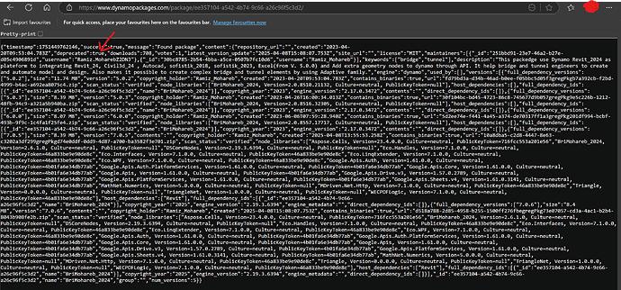

I am not entirely sure, but can you check if any filters are on?
Your package is set to "deprecated:true ", this may be why it wont appear in dynamo
BriMohareb_2024
BriMohareb_2023:
thanks @Brendan_Cassidy
how can i change it
I am not sure but maybe in the package management when you upload you can change it?
