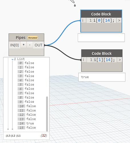

How can I get a bool when my paramater has no value?
#alle elementen van OST category ophalen
alleElementen = RDB.FilteredElementCollector(doc)
alleElementen.OfCategory(RDB.BuiltInCategory.OST_PipeCurves)
alleElementen.WhereElementIsNotElementType()
#ID ophalen voor parameter
ID = alleElementen.ToElementIds()
ParameterNaam="bouwnummer"
param = list()
for MyE in alleElementen:
try:
param.append(get_parameter_value_by_name(MyE, ParameterNaam))
except:
param.append(None)
bool = list()
for check in param:
if check == None:
bool.append(True)
else:
bool.append(False)
OUT= param, bool
I tried to use this methods, (after create a string)
for check in param:
if check == " ":
bool.append(True)
else:
bool.append(False)
for check in param:
if check > 0:
bool.append(True)
else:
bool.append(False)
Thanks in advance

Hmm now it works fine. I don’t know or this is the right way to do…
bool = list()
for check in param:
if check == "":
bool.append(True)
else:
bool.append(False)

What I want is check the parameter values.
I want a true if the parameter is not filled.
@Andrew_Hannell
You’re way works, thanks for that.
What is the safest way to check the value?
O!
Then your method checking for "" works just fine. It will read it as an empty string, which, technically speaking still has a value. Think of it as the string equivalent of 0.
