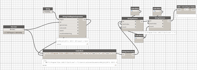

I’m getting somewhere.
Python code with CMD and 7zip was the way to go.
It leaves me with extracted BCFzip in a folder though.
Below is the Python code:

I didn’t continue the topic and left it as described in my last post.
At the moment I think that the only solution is to use Windows command line and a 3rd party software like 7zip (which can be executed within command line). Navigate to bcfzip, unpack, read, delete unpacked files.

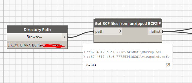

It is and was working, as described in the post with the screenshots.
Let me clarify. Reading the contents of the files was not the issue mentioned in this topic. The issue was only to open the bcfzip files without extraction.
Reading the content of these files depends on your knowledge about their structure.
