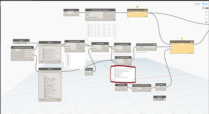

Good afternoon @GavinNicholls I was testing your definition and it is close to what I need, which is to open the families of a project and load shared parameters and load it again, however, I see that only 1 parameter can be added, I don’t know if It’s a lot of trouble. Please help me modify it so that it adds a group of parameters, as shown in the image.
Something that I just realized is that the Python Script (Edit family) sends an error, would you be so kind as to explain me why this error happens, I am a newbie in Python.
I thank you in advance for your help and attention.

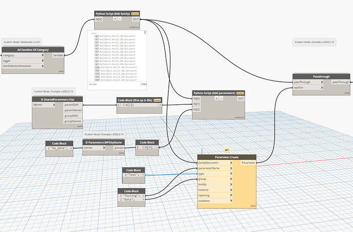

You have changed my code so it isnt working for that reason. You’re using a different clockwork node, it should be all all families of category instead of family types. You’ve also limited the parameters to one using the code block with x[1] after the parameters.
If you use my script/code as is it should work I’d say.

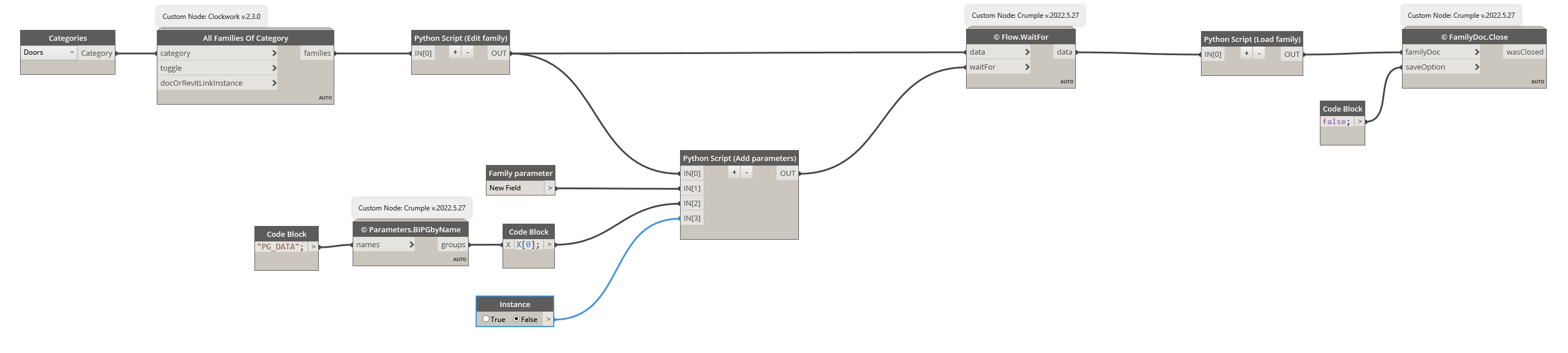

i am using this script again now i do need the shared parameter… but how do we set it as a type parameter it is now set to instance… would be nice to have the option
found it in the script the true or false controls the type or instance parameter
