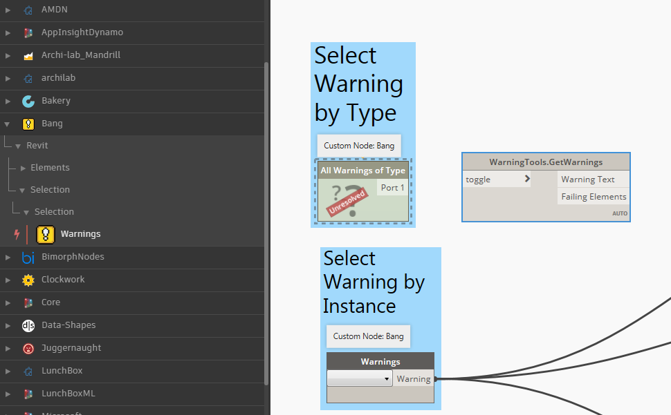

I just noticed the dropdown node for warnings in the latest update has disappeared. We need both nodes: WarningTools,GetWarnings and All Warnings of Type. Please!
That should not be the case, which version of Revit/Dynamo are you in?
Hi John,
I am using Revit 2018 and Dynamo 1.34
The node that I am not seeing is “All Warnings of Type”.
Thank You

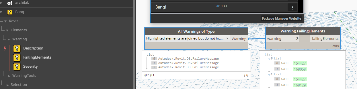

In the library, navigate to bang and see if you have a selection category. Also, what does the yellow error say?
Thanks for the info. Let me do some more digging.
Figured it out. I recently swapped to using a desktop and forgot to sync some of the old code from my laptop to the new package.
This is now updated and is version 2019.3.1
