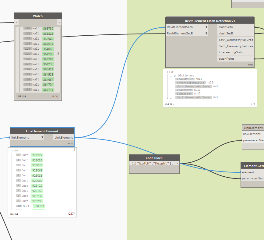

Trying to run a clash test between ducts and walls using Backery custom nodes while running the script i am getting null values. Could you guys please help me out.
Hello and welcome to the forum…think its long time ago Bakery had been upgraded, but probably some lacing could work…but another great option is take a look at Bimorphes thats work very well.
