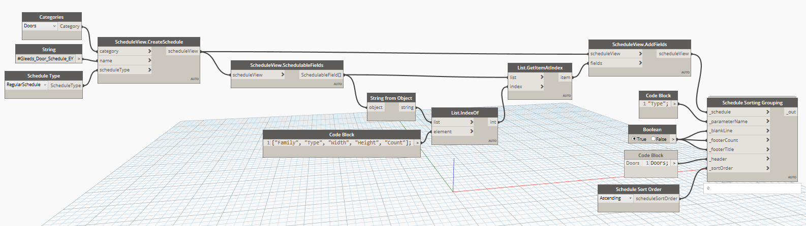

So, I’ve been trying to automate Quantity take offs for Revit and I created a simple dynamo script shown below; Now I have a couple of questions:
  1. Is there a smarter way to create multiple schedules for multiple categories (Multiple Categories schedules are not an option) or do I have to copy paste the entire block for each indvidual category?
  2. I filtered out specific parameters i needed in my schedule; but I still need the other parameters to show as well, I Just need the schedule to have the filtered parameters first.
Much Obliged!

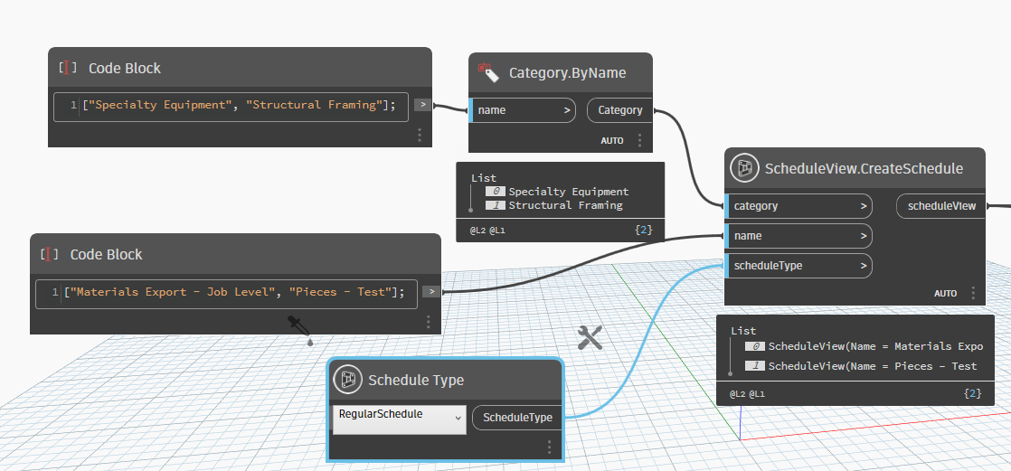

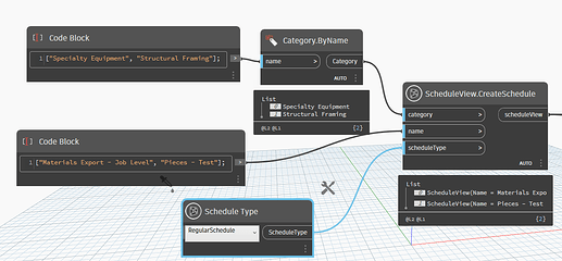

For the multiple schedules with different categories you can do what is shown in the clip. List out the categories and use the Category.ByName node. You may have to monkey with lacing and levels on some of your other nodes to get the fields brought into each schedule. I don’t quite understand your second question. Are you talking about hiding the fields?
