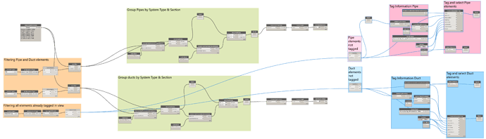

Now I have a list with data
Can you maybe tell me how to get this converted into elements again so I can tagg these items?
Easiest way is to use SortByKey to sort the elements by length. This will sort the elements shortest to longest, then all you have to do is take the LastItem.
Thank you very much @Nick_Boyts,
It’s working great now! You’re a life saver!
I post the total solution for future fortunate seekers…
With loads of credits to Alban_de_Chasteigner and Nick_Boyts. Thank you very much!
