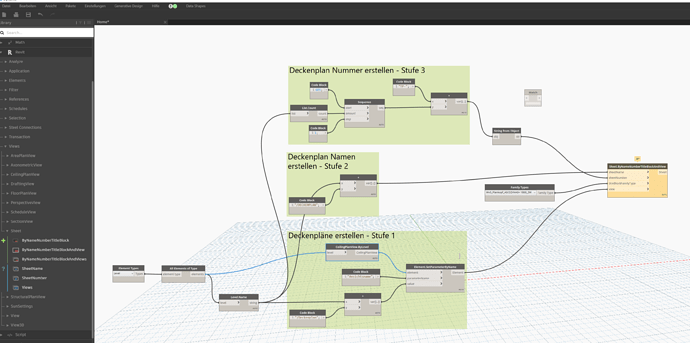

Hello Guys, i am relatively new to working with dynamo and i tried placing views automatically on sheets which i created using dynamo. I only have a problem with the last phase of placing these created views onto the sheets. it says : sheet.ByNameNumberTittleblock view 0 could not be packed on the sheet due to different sizes. Please see the image uploaded…

So I think it’s about error catching as best you can… I expect there will always be rogue ones.
Try with a very simple example you know should work and go from there.
Make sure all views are cropped. Maybe apply scope boxes? Perhaps check that the size of the viewport is within a certain range? Perhaps up the view scale just to get them on the sheet? I’m sure you can think of other ideas… :slight_smile:
