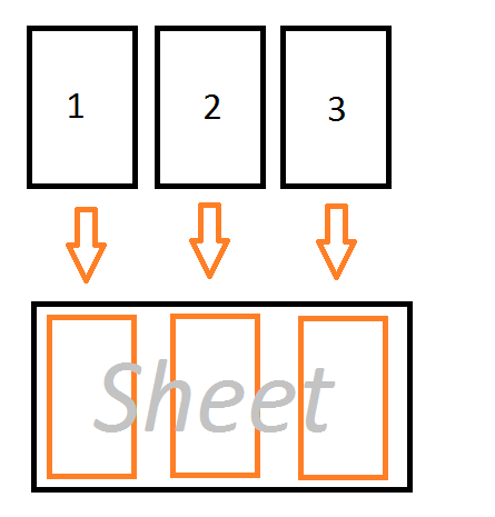

Hi Guys,
I’ve been working on a dynamo script for a few weeks right now but i’ve a question,
Is it possible to create (section)views (from revit) automatically on sheets?
Let me know!

i’m just researching about it, did you find a solution? appreciate your answer
Welcome @Arturo_Rima
Assuming the views have already been created, then yes you can use the Rhythm node below to place the views onto sheets at specific locations.
