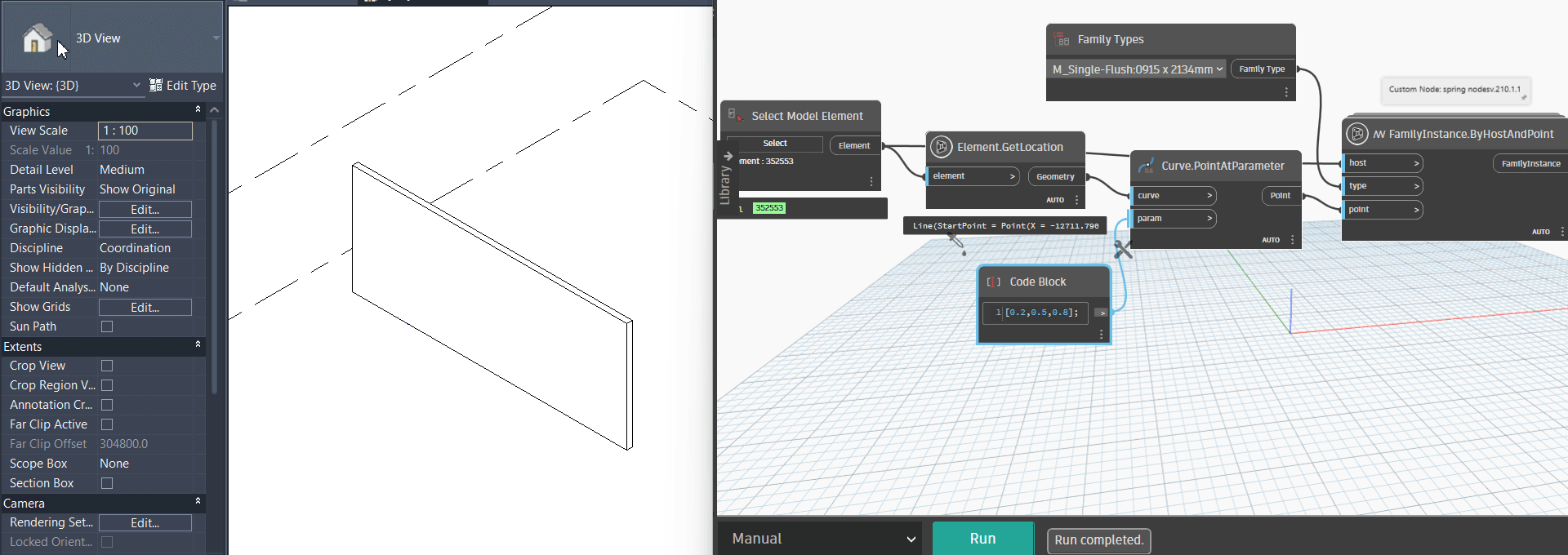

Uploading: Screenshot 2024-02-28 143650.png…
I used the select wall element node to select the wall section I am interested in, associated the family however now I don’t know if it is correct to use family instance by face or not. what parameter do you mean should I use when you suggest “Use point at parameter to work out how far along the wall you want the door
Then place family”?
thank you very much
try this one here from spring…and see if it could work for you…
