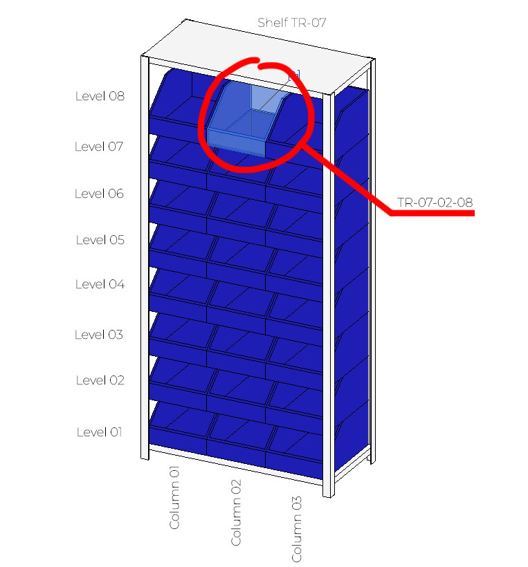

I’m currently trying to automate the assigning of a sequential number to different elements that conforms a shelving unit in my model. Each element has to be numbered according to the next convention: TR-0X-0Y-0Z where X represent the number of the shelf in the model, Y represent the column where the object is located inside the shelf, and Z represent the position number inside the column as shown in the next image:

Not sure how the Family is set up. Are those blue Families Shared nested?
If yes then you could then do something with XYZ coordinates maybe?
X(Y) = column and Z (or the Level) = shelf?
