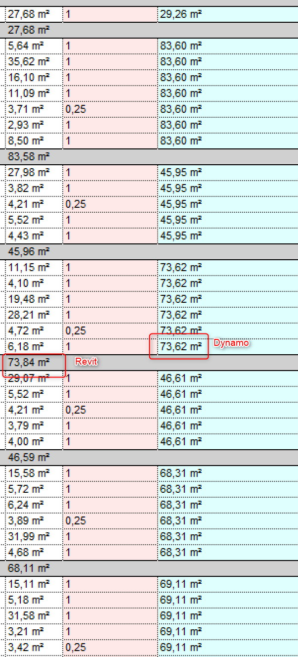

I collect areas from an apartment (kitchen, living, sleeping,…) and put this roomvalues (m²) in a separeted area parameter. It worked perfectly
BUT, the results slidly are diferent, why? What is Dynamo doing? or have to adapt some roundings? and how can I do that?

Dynamo doesn’t do rounding unless you tell it to so i’m guessing it’s the schedule that rounds it
the collegs run the script… and did afterwards changes in the modell :slight_smile: finally it is no dynamo-issuses
