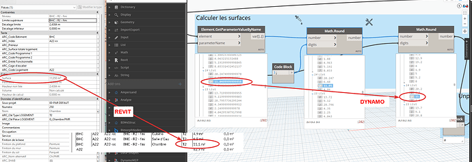

I’m created a script that get all rooms , group the rooms using a parameter that is the flat number, sum the surface of the rooms of each flat, and then write the surface of the whole flat in the living room of the appartement.
Until there, no problem
BUT
I have an issue with rounding.
I have a room that revit shows with an area of 11.050 sqm.
This value is rounded to 11.1 in Revit, and to 11.0 in Dynamo.
In fact, the crazyest part is that, with dynamo, I can see that the value of this room is not 11.050 but 11.049999999956 and I don’t understand why Revit round this to 11.1 …
Do you have any idea of how I can mimic Revit rounding system to get a consistent value between revit and dynamo, and be sure that the total value of each appartement is the same in plans and in schedules ?

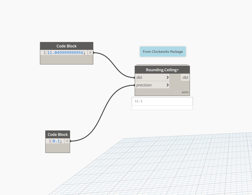

If you want to match what is in revit you can use the “Rounding.Ceiling+” from the clockworks package

The issue with the node you propose from Clockwork Package is that in this case, All the values will be rounded to ceiling, and not only those that Revit mis-round, …
And so even if 11.04999 get the good value, all the others values are unconsistent with what revit does…

Just to clarify, this is two different things happening at the same time.
  1. Revit will round values to the specified precision of the project units for that parameter. This can be overridden in schedules and other places. If you want to match the value shown in the schedule, you have to know what the rounding is for that column (or maybe get the value directly from the column).
  2. Revit and Dynamo use different methods for calculating precision values. Sometimes, due to rounding and whatnot, Dynamo will return a “more precise” but mismatched value. It’s just a rounding thing, almost never enough to actually make a difference in any calcs (we’re talking immeasurable precision). Just round it if it bothers you.
