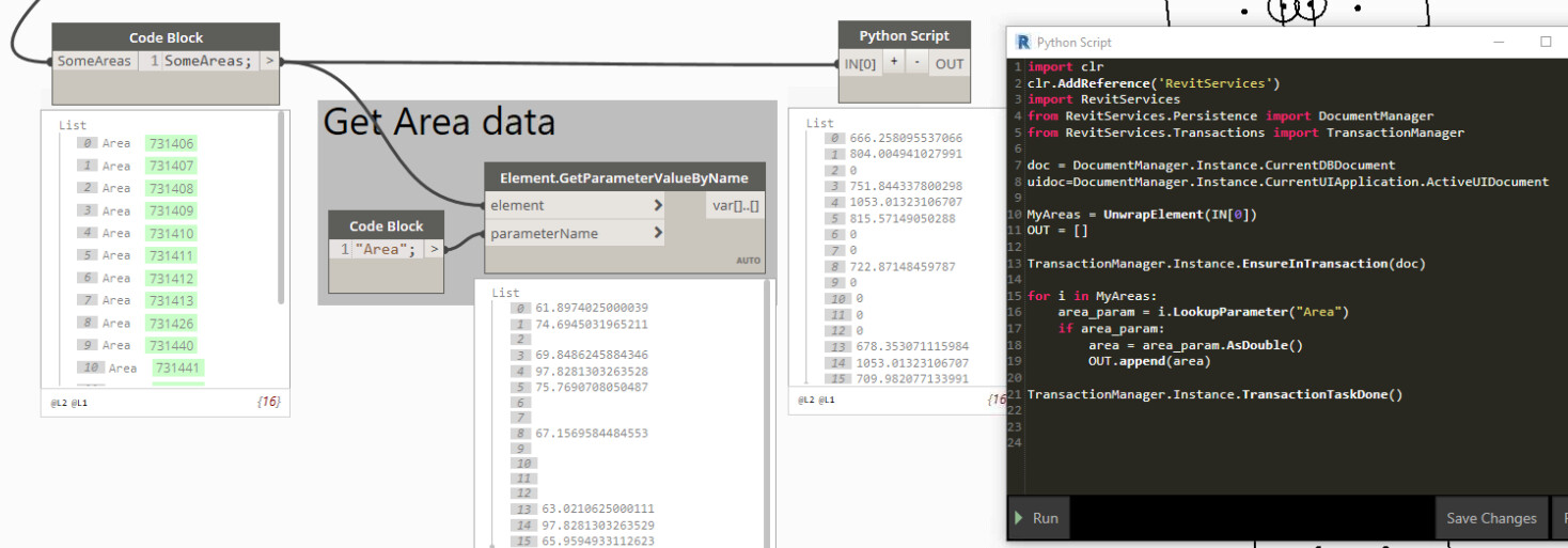

Area of areas in Python
I’m really confused… What have I done?
I have the area using Dynamo and the area (I think) using Python…
Yet the Python one seems to be 10.76 times larger. Why?
Revit works in Feet under the hood. Dynamo does some of that unit conversion for you. Since you’re in the Revit API if you want meters you’re going to have to ask for the value to be returned as such. This gets difficult to sum up with the Units API changes, but there are several good examples on the forum already. Give it a shot and see where you get.

Hello, add this to your code, if you want m2 area=area_param.AsDouble()*0.3048**2

That’s 0.09290304 which is the number I was thinking of to start.
I multiplied it by 10.763910416709716061984585413053 and it’s happy. :smiley:
the foot power 2 your answer😉
1/(0,3048**2)
