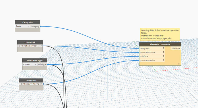

Hello everyone, I am having real trouble getting the FilterRule.CreateRule node to work without having any real clue what’s not working. The warning I’m getting is the following:
My Revit version is 2021 and my archi-lab version is 2024.217.1024

You’re using the wrong version of Archilab-Lab. Check the link for identifying which version for your Revit build. Note that you will need to uninstall Archilab, restart Revit, and then install to repair this.
