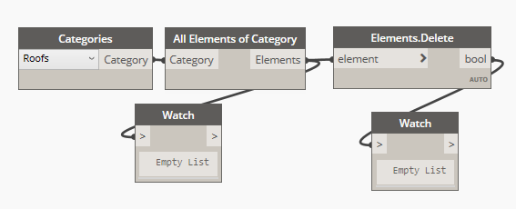

Archi-lab.net package version 2019.2.1 works. I don’t know what the issue is that you were experiencing.
For future posts please, attach images of any errors, and minimal sample model for us to be able to re-create the issue. Like @jacob.small was saying there might be all sorts of reasons that would cause the graph to fail. I would for sure start with looking into things in that list. Are there Element Types on that list. Deleting a single element type would also delete all of its instances, and invalidate any other ids in that list causing an exception. This could be just one of the potential issues.
