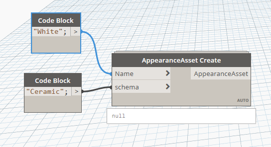

I am trying get appearance asset from the asset browser by using GeniusLoci but it shows null anyone know the reason.

@Alban_de_Chasteigner thanks but still Null
I think the error is pretty self explanatory: you are using a version of Revit where it’s not possible to create Appareance Assets (before Revit 2018.1).
I will add a warning in the custom node properties.
Is that possible to get Asset from 2018.
@Alban_de_Chasteigner thanks it’s working in 2018.3
