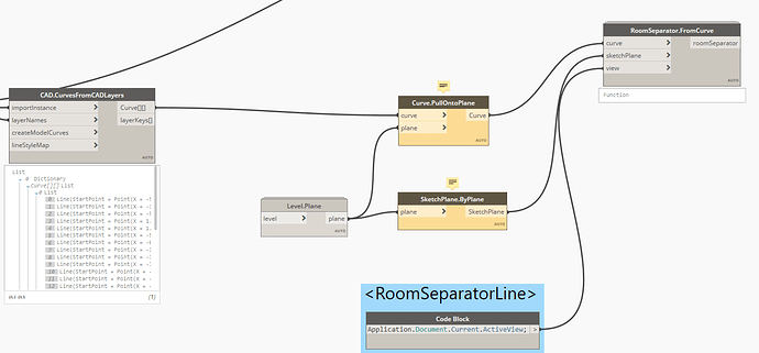

I merched to scripts:
1.) Select Lines from a .dwg -> it works
2.) Convert Modellines into RoomSeperationLines -> it works

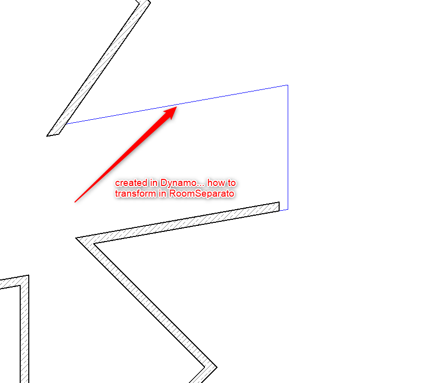

3.) How can I convert the collected Lines from the .dwg into RoomSeperationLines ???
I am glad about any advice
KR
Andreas

There is a small error I think, do you have any idea?
Is it the plane?
the output is a “function”? Why?
KR
Andreas
it doesn`t create the roomseperator
try a flatten node or list@level for the curves, as you can see they are in a list that’s in a dictionary and another list
and check your active view it should be a floor plan
