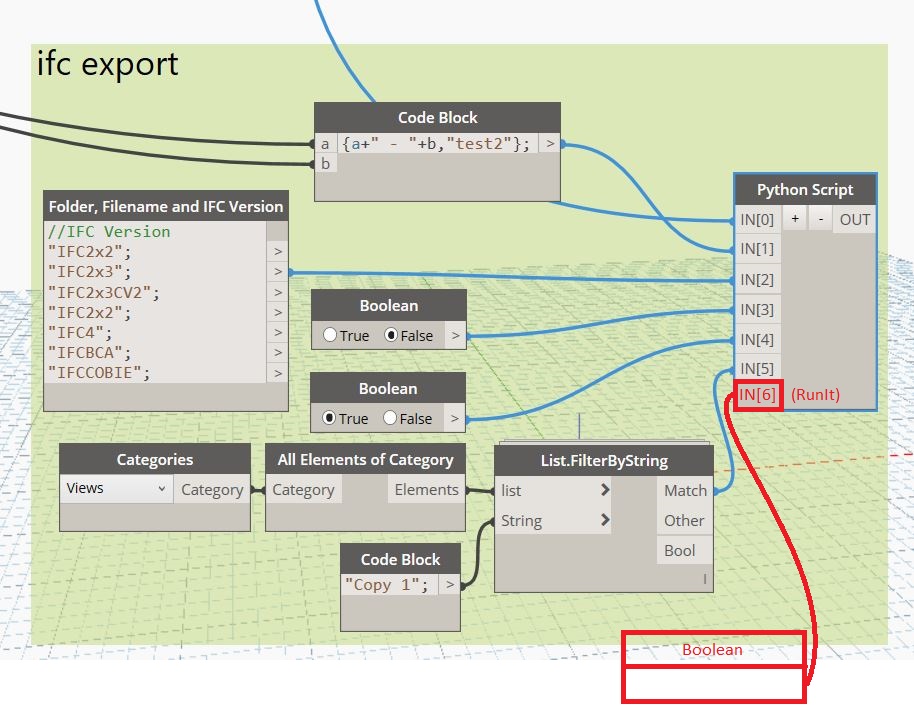

Hello all,
I’ve been creating a dynamo script with the ability to export the file to dwfx and to ifc. On the forum I found a really helpfull python script from Julien Benoit with some modifications by Nicklas Verdier. And I have been using it since. But now i want to add an extra RunIt option (boolean), I’ve been trying some things in the python script but I can’t get it to work. Could someone please help me with this?

Shouldn’t this do the trick?
(Adding an if sentence around the whole operating code, and if the boolean check is not met, then the output is “Not Run”)

Thank you very much, this was all that need to be done!
