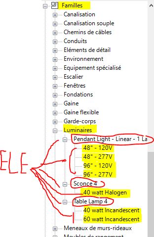

Hey !!
Question 1 - i want to rename Family Type in my project , just add the prefix ELE_LUM_ to the family type of the Category : Luminaires .
i did my script like this but i can’t push the new names from revit to dynamo so if you could help me i will be thankful.
Question 2 - Also i want to add the same prefix ELE_LUM_ to the family name in the Category Luminaire but i cant chose the family name in dynamo ;
is there a method just to filter the wanted family name in dynamo
instead of choose all the families names in all the project?
thanx for helping :slight_smile:
here is the first picture of the project browser where i want to add the prefix ELE_LUM_ to the family type and also to the family name ( family typen are in yellow and family name are in red)
Thanx :slight_smile:project%20browser%20(Family)
