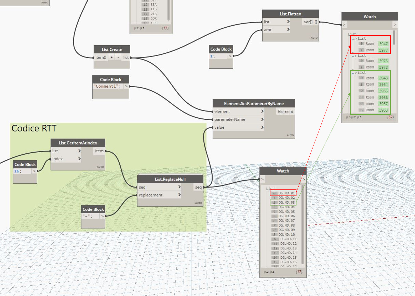

I need to add value from Excel into a grouped list of revit.
In excel I have some values ​​concerning a series of “Rooms” of the same type.
How can I solve the problem?
Element.SetParameterByName.

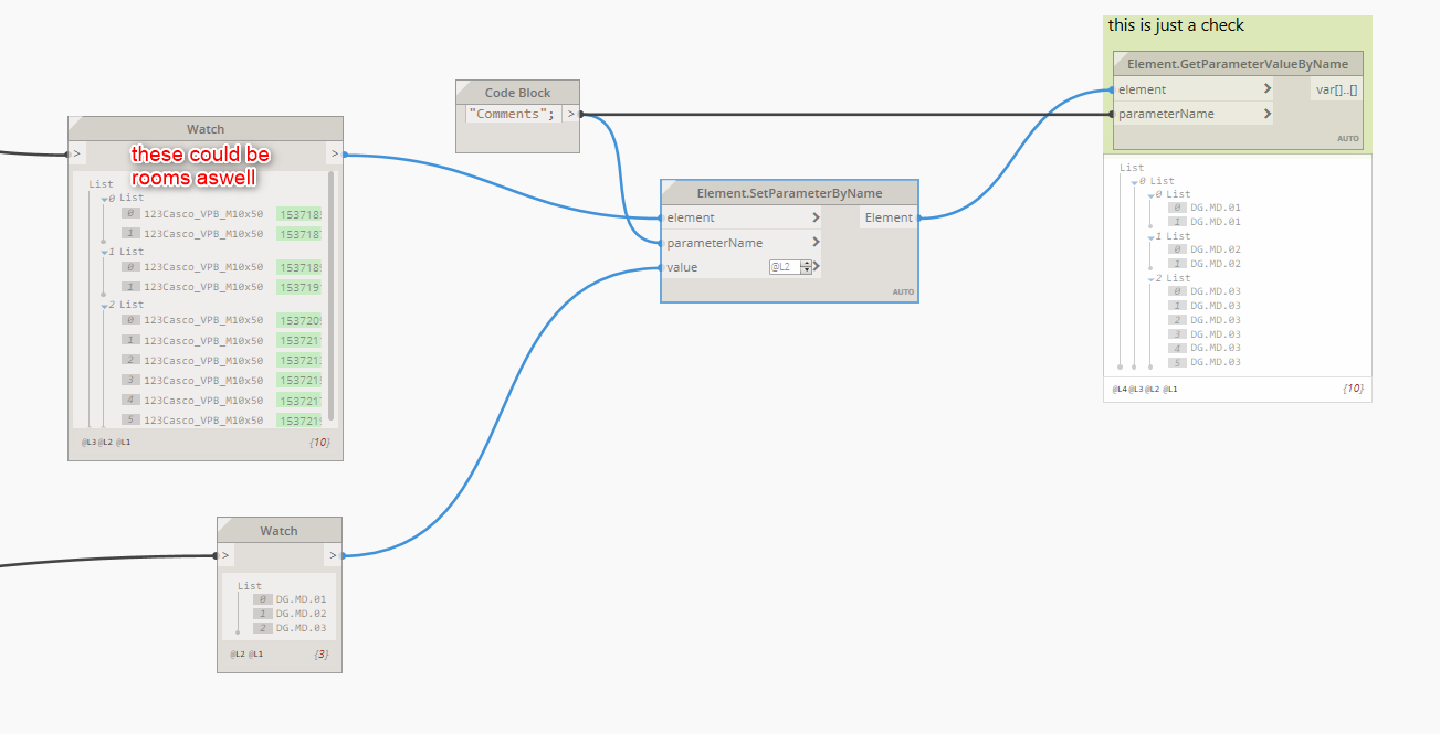

i believe you have 17 nested list in your element right? you can either duplicate the values and make it into the same list structure as your element, or try set the lacing of setparameterbyname to longest
As @jacob.small said Element.SetParameterByName. Take the Element @L2 and value @L1 if it doesnt work by default.
Make sure you have the same amount of Lists (17) as values (17)
