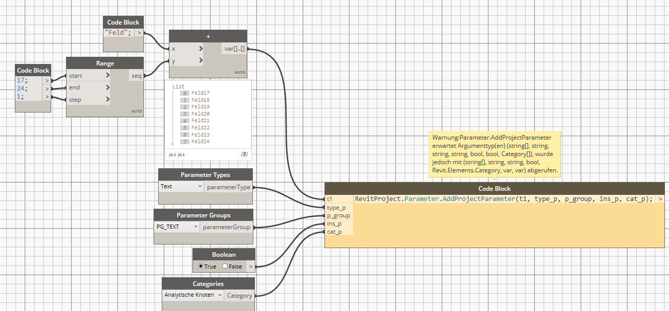

Check Parametertyp. You created new parameters as Gemeinsam genutzter Parameter but in Dynamo with Projectparameter node. I guess the error is there. Try to create new parameters with SharedParameter Node.

I created a Gemeinsam genutzter Parameter (german for SharedParameter).

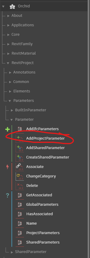

But i want a ProjectParameter. Thats why i use the ProjectParameter Node and not the SharedParameter Node. Allthough Both Nodes got the groupName input.
What do i have to fill in groupName to get ProjectParameter instead of a SharedParameter?
I don’t have Revit 2020 and Dynamo 2,3 but it seems like they had changed something there. After you type “RevitProject.Parameter.AddProjectParameter(” it will give you the variable to enter. I see that there are 2 Bools in 2020. Can you take a screenshot after you type RevitProject.Parameter.AddProjectParameter(
