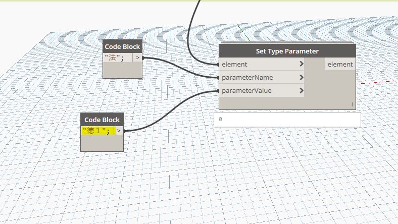

After I filter the door type , I want to add new information for door in the Type Parameters of Type Properties. But I can’t . Someone can help me? Thank you very much.

Now, I change Node" Set parameter by name" to " Set type Parameter". But I still have problem when it just display 1 part of " value" (just the second item)
Can you help me.

I tried it in English but I still fail. Do you know the reason? or do you have anyway to make it?

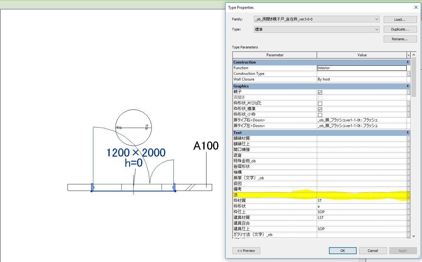

That Parameter group is Text. And I want to fill Information that a string and an integer.,…
I create the tag door and have more type of door.And every door type name has differ information. Some type just a string, some type have both ( string and integer),…
If I input that information in “type properties” , It will appear with the tag door.
You can see the picture below.
Can you help me.
My guess is that it’s an issue with custom node, perhaps due to the language pack, or creating an issue where you are setting different values for the same type. Try getting the Element Type for each element, ensure you only have unique elements, and then build up the desired tag values accordingly.
