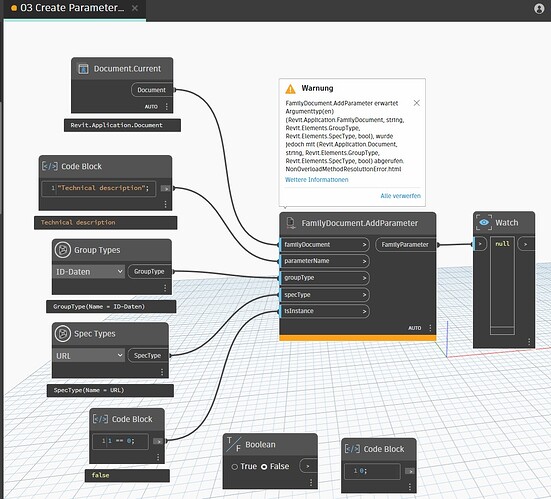

add family types with Dynamo to an existing and loaded family with FamilyDocument.AddParameter doesn’t work? I’ve tried different variantes. Evertime same the same results (wrong parameter input)? ChatGPT can’t help.

correct inputs ()parameter) for the node “FamilyDocument.AddParameter”
yes you could use that graf, but then you had to be in a family [edit family] document, but now you input the document and not family document, there is a ootb box for that to family document i think is called…not at dyn in the moment…ps now i read your headline again, is it a new familytype you will create or a family parameter ?
document is family document
yes but not "converted…try here and be sure you in a family document
just a new parameter into an existing family
great, no warning messages anymore and the parametr is set. Thanks a lot
