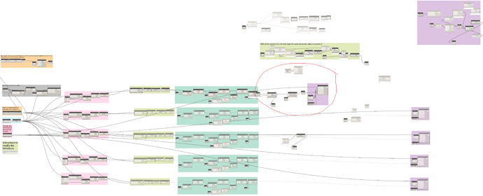

Write sums element, insert them with Python into one list and to Excel
I managed to write a python script to sum element of a list, than
insert the sum as a line into the list.
I checked on Online tutor python execution, also Anaconda and it worked.
When I pasted this script into python node I get some errors.
I surely misplaced something there .
It maybe something simple , so far I have not found the solution yet.
While the purpose is somehow silly, I think I can use this solution for other purposes as well If I get it right!
Working versions on Revit 2017 and Dynamo 1.2.1 3083
Any hint would be appreciated
I upload also the overall graph, a red circle indicates where I inserted the python node.
I tried also to read some design script instructions, but as I understood I needed
to go into imperative mode for changing lists. It helped me to understand more about Dynamo but I could not make it functioning thus I went back to Python.ListSumsandInsertelement.py (3.3 KB)
I uploaded also the python definition “standalone”…
Please upload your Python code and/or dyn file and a sample rvt file to run it on.
Note that Dynamo only uses ironpyhon which is 2.7 so if you call modules or methods not in that version it won’t work.
The warning states “float is not iterable” meaning that Python is expecting an iterable list and is receiving a single float instead. Check to make sure all your lists are structured correctly.
Thanks. At the moment I had to leave the work as it is. I will come back. Since I cannot forward a file (it would be in Japanese btw) i will try to recreate the situation in a new file, maybe the Autodesk sample would work fine for this purpose.
