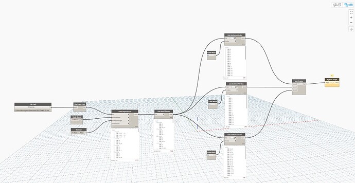

How would I change this into a Python script?

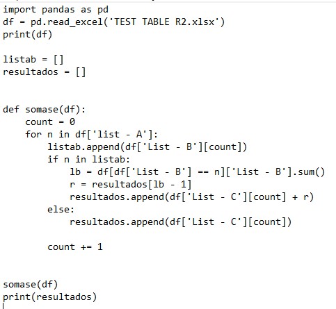

This code takes information from Excel and does the calculation.
Screenshot_22

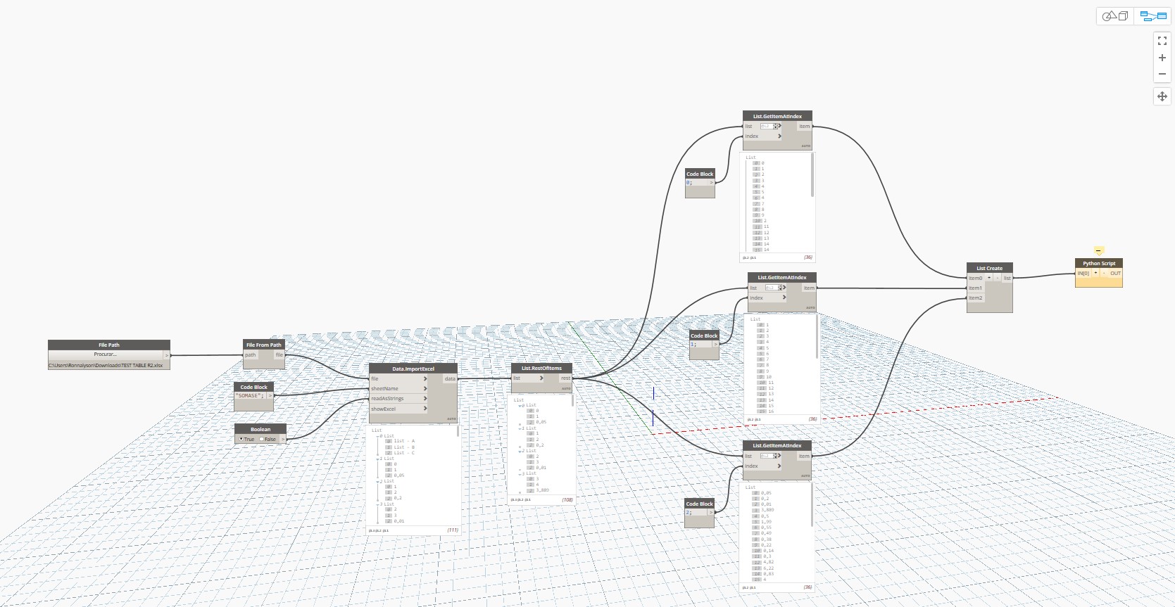

In the dynamo. initially I imported excel and separated the columns to later play on PYTHON SCRIPT

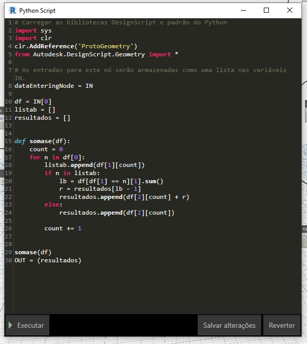

In python script I adapted to this format, but it didn’t work

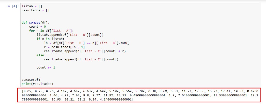

on Jupyter notebook it worked

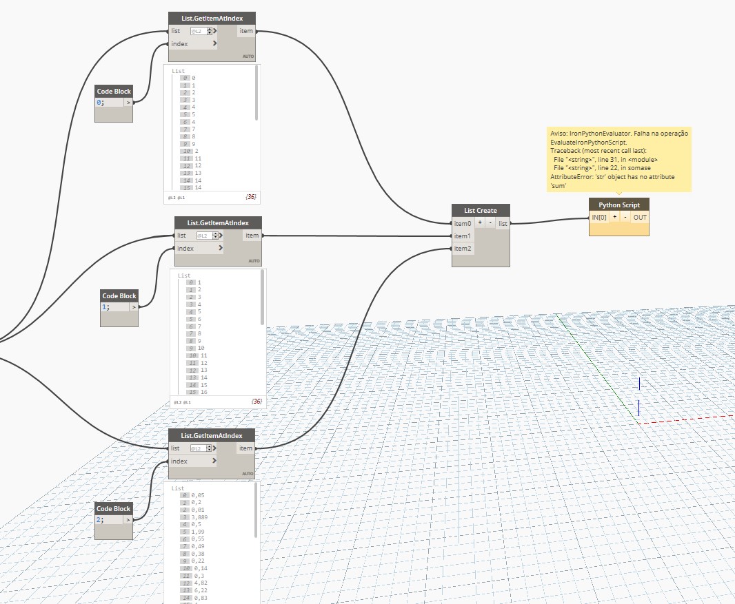

I think you try tot calculat with strings.
@ronnalysonloiola have you tried changing number format, for example from 0,05 → 0.05. And remember you are using IronPython in Dynamo so some functions that you use in Jupyter won’t work as .sum(). You are probably using attributes from Pandas library. Try amending your numbering format and amend your code so you are not using external libraries!
