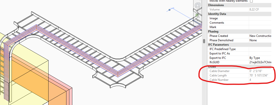

i created instance project parameters and write values via coding, need to be read-only for obvious reason, in UI, you can use formula like “= 123” to make it read-only, how to achieve it in Dynamo/Python, i assume API’s SetValueString is the way.

value is calculated on the fly when creating that element (in-place family) via coding, user may modify that value afterwards which is not desired (because any other value is incorrect)
