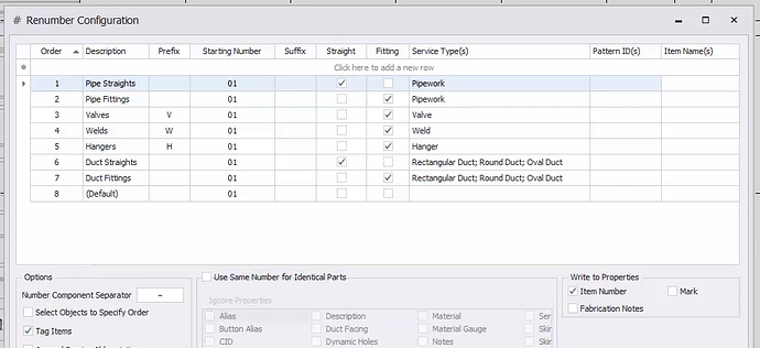

User interface in dynamo
how can create a user interface in Dynamo as shown below
Using WinForms or WPF.
