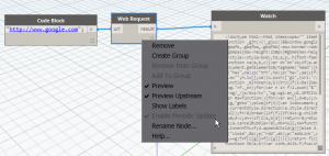

Technically it’s been available for a while. However the only way to expose it, is to create a custom c# node. The only OOTB node that supports the functionality is “Web Request” :
