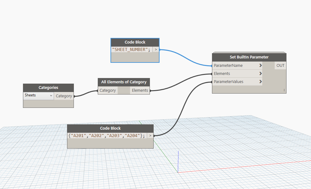

Hi, you could try to use the “Set BuildIn Parameter” node. I don’t know what kind of parameter is “номер листа” if it is the original Sheet Number parameter the Set BuildIn Parameter node from archilab package should do the job. I used it in my previous script where I have similar problem like you. For the name of the parameter you should feed “SHEET_NUMBER”
Here is quick example:
Thank you! This is realy cool node!! All working
I believe in your previous post you typed the wrong parameter name. With “SHEET_NUMBER” everything should be ok = )
The problem is caused by the fact that there are multiple parameters behind the regular Sheet Number parameter and to be sure you are accessing the right one you need to use Set BuildIn Parameter.
I’m happy that everything is ok now.
