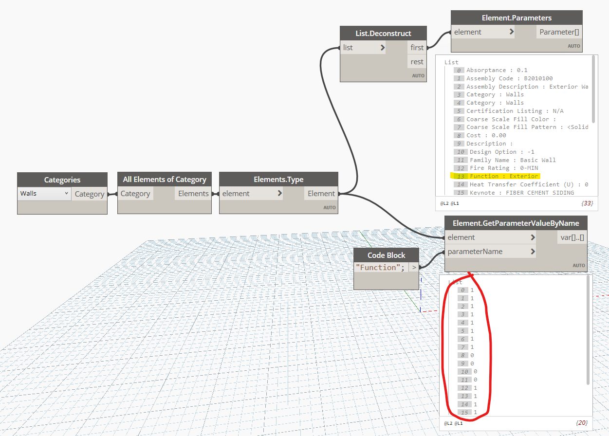

I just figured out how to retrieve the Function parameter of my placed walls; now I am wondering why the Get Parameter by Name node is returning a list of 1’s and 0’s (which I am guessing are a form of booleans, but I could be wrong). In the Element.Parameters node, the Function is stated as a string, which is what I desire. So why is the same parameter name not returning strings when I try to retrieve it?

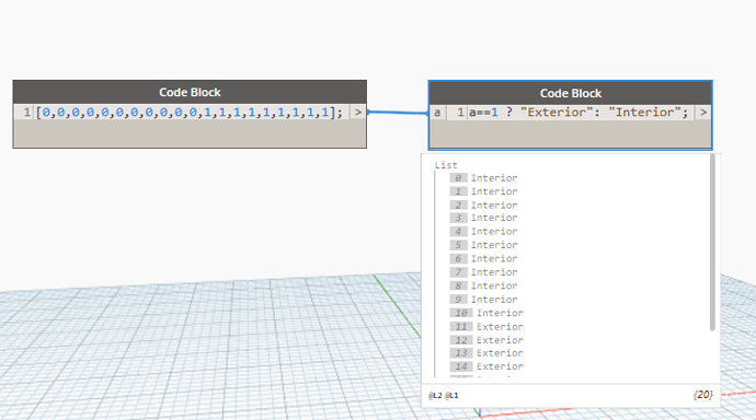

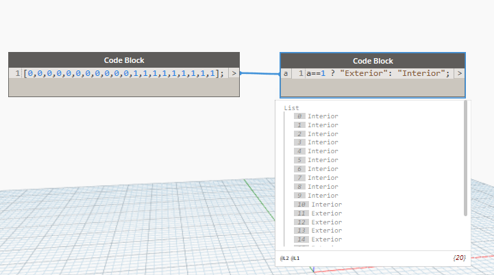

allright…think 0 is interior and 1 is exterior

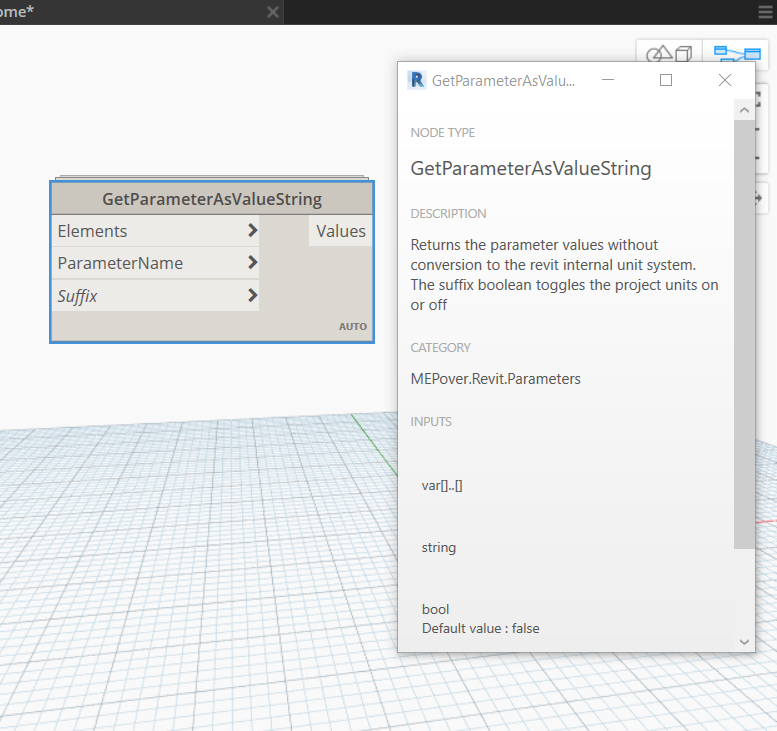

That looks promising! Which package is this part of? I don’t see it in the OOTB library nor any of the packages I have installed.

Because that is an enumeration in the RevitAPI.
The specific values are here:
https://apidocs.co/apps/revit/2022/ccafc685-892f-511b-1db6-e7bf1116268d.htm
With parameters like this we have both the int value and the string value available. The Element.Parameters node exposes the string values of the parameters so that is why you see it like that.
Also, when setting these parameters you will more than likely have to use the int.

I like the package, thanks for mentioning it! However the node did not work with the Wall Function parameter. I just want to note that here for future reference.
