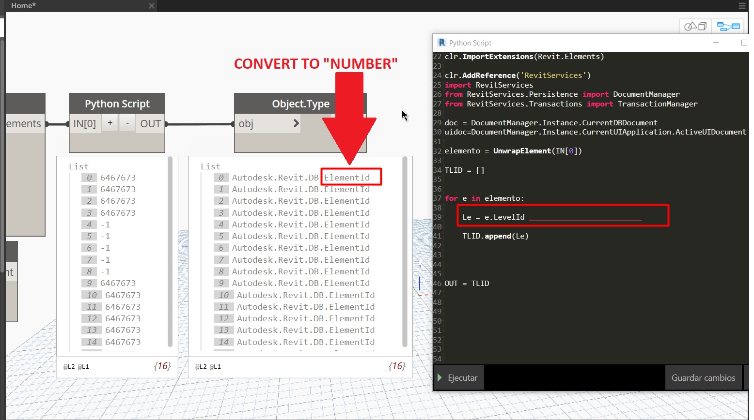

I am trying to know what value is inside the LEVELID parameter if it is a value or it is null…

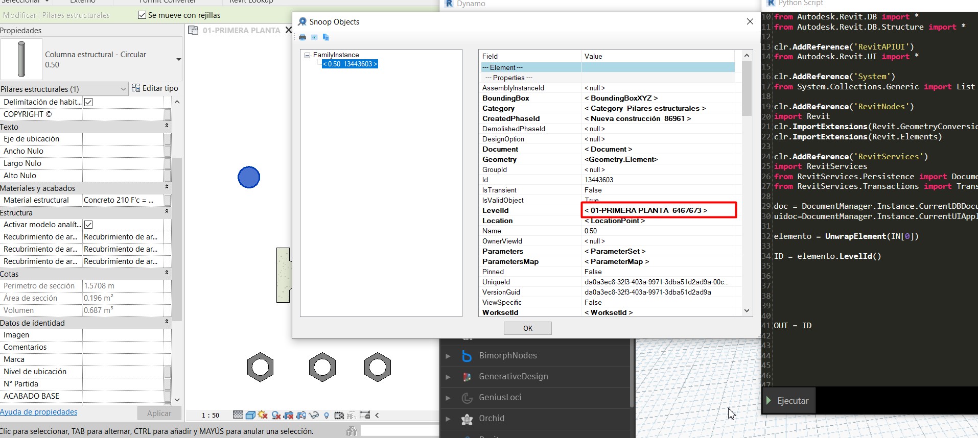

levelid is a property but not method
you can use
ID = elemento.LevelId
then u can get its level by
level = doc.GetElement(ID)

HOW CAN I CONVERT LEVELIDS TO NUMBERS…?
What would be the correct method … thanks

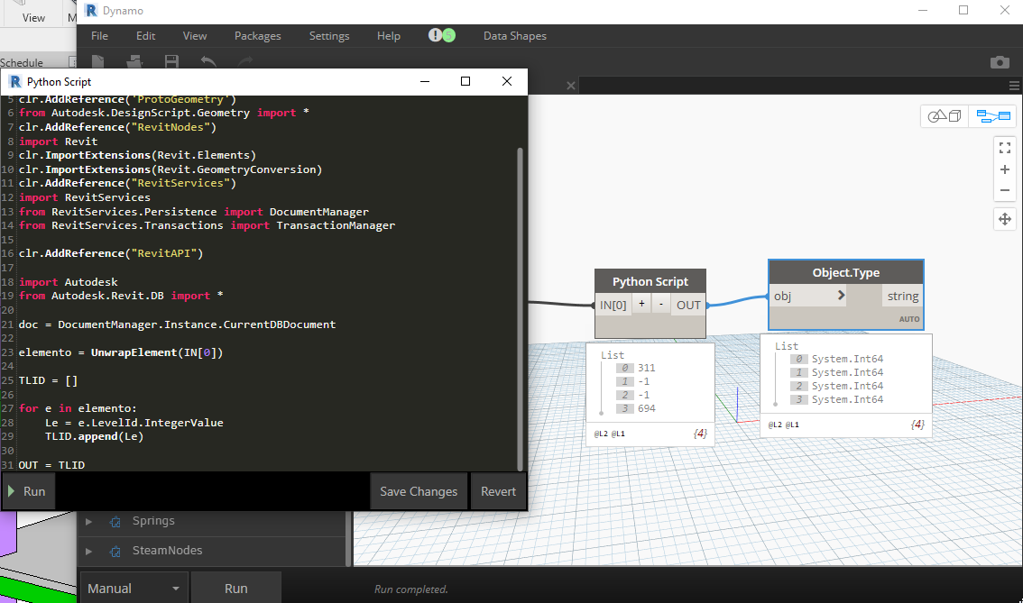

you can use this:
https://www.revitapidocs.com/2020.1/f7074647-9521-0f64-d2e2-eb2401aace85.htm
Thank you very much for all your time… I am grateful for sharing your knowledge… thank you
