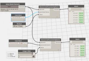

does anyone know how to change the structural usage of a wall?
i.e. from Bearing to Non-bearing
Hello Peter,
You can set up the “Structural Usage” parameter like any other instance parameter, however what you need to feed in is an integer value.
1 = Bearing
2 = Shear
3 = Combined
If you want to switch the “Structural” usage, you will need to feed a Boolean value.
dimitar thank you. i didn’t check to use a boolean … shame on me;-)
