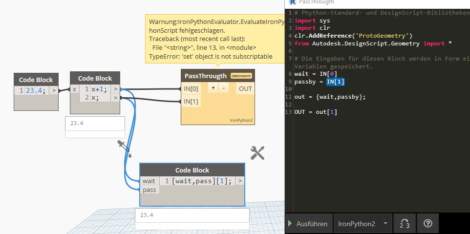

i have still some trouble to run. Does anyone have real example? why have I a “set” Error?
wait = IN[0]
passby = IN[1]
out = {wait,passby};
OUT = out[1]
wait = IN[0]
passby = IN[1]
OUT = out[1]

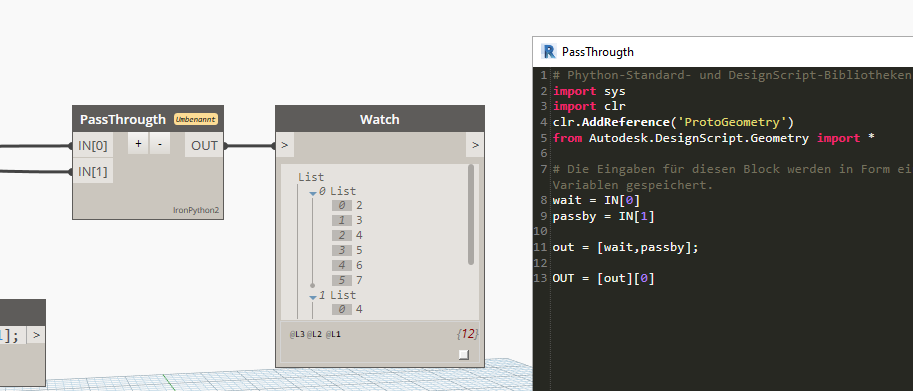

does this work?
out = [wait,passby];
OUT = [out][1]
“1” is out of range… “[0]” does work
wait = IN[0]
passby = IN[1]
OUT = [out][0]
so remove the [ ] of out because it is taking both lists as a single combined list and you want the second I understand
wait = IN[0]
passby = IN[1]
OUT = out[1]
