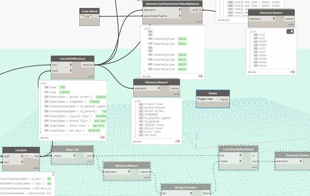

We have found something weird in one of our rvt files, two views that are not listed in the project browser but dynamo is listing.
These views are called Project View and System Browser
Any ideas what these are and how can we get rid of them?
We have only seen this in one file, might be because the file is damaged?

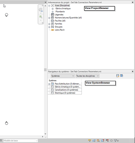

I believe these are hard coded views related to internal tools. Try selecting by ID in Revit and see what happens.
Hello
System Browser View and Project Browser are “Interface User” Views
you can try to filter them

But why they are only listed on this file and not anywhere else?
